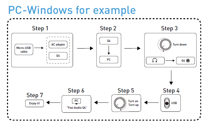

Quick Setupโ€‹
Preparation
PC-Windows, for example.
Prepared Q4, PC, AC adapter, PC-USB cable, Micro-USB cable, and headphones.
Step 1: Connect the Micro-USB cable to the AC adapter, then connect the Micro-USB cable to the Q4;
Step 2: Connect the Q4 to the PC via the PC-USB cable;

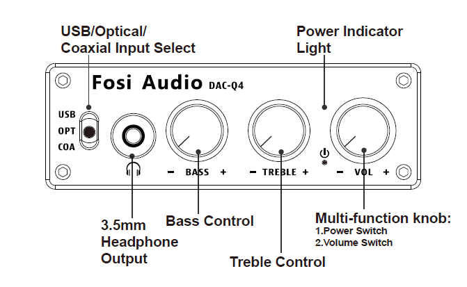

Step 3: Turn down the volume control to the lowest level (turn off the power switch) and connect the headphones to the 3.5mm headphone jack;
Step 4: Adjust the input mode selection key to select USB input mode;
Step 5: Turn on the power switch (turn up the volume); (Note: The power switch is also the volume control knob.
Turn on: Turn the volume knob clockwise to the right;
Turn off: Turn the volume knob counterclockwise to the left and adjust the volume to a minimum.)
Step 6: Left click on the computerโ€™s desktop sound icon and select
Device: โ€œFosi Audio Q4โ€ณ (Digital HiFi Audio);
Step 7: Open the audio application, play it, and enjoy!
(Note: Before connecting the power supply, please turn down the volume control to the lowest level to avoid damage to your hearing.)

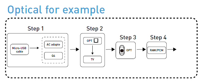

Optical for example
Prepare Q4, AC adapter, Micro-USB cable, optical device (TV, for example), and optical cable.
Step 2: Connect the TV to Q4โ€™s optical interface via the optical cable;
Step 3: Adjust the input selection button to select optical mode;
Step 4: Set the TVโ€™s optical output sound to RAW/PCM;
(NOTE: Due to different TV types, some TVs default Dolby or DTS sound output, Q4 DOES NOT Support Dolby and DTS sound, please select RAW/PCM Sound; otherwise, you will hear a lot of noise or no sound output.)
Step 5: Open the audio application, play and enjoy

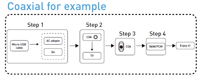

Coaxial for example
Prepare Q4, AC adapter, Micro-USB cable, Coaxial device (TV, for example), Coaxial cable (no include).
Step 2: Connect the TV to Q4โ€™s coaxial interface via the coaxial cable;
Step 3: Adjust the input selection button to select coaxial mode;
Step 4: Set the TVโ€™s coaxial output sound to RAW/PCM;
(NOTE: Due to different TV types, some TVs default Dolby or DTS sound output, Q4 DOES NOT support Dolby and DTS sound, please select RAW/PCM sound; otherwise, you will hear a lot of noise or no sound output.)
Step 5: Open the audio application, play, and enjoy!

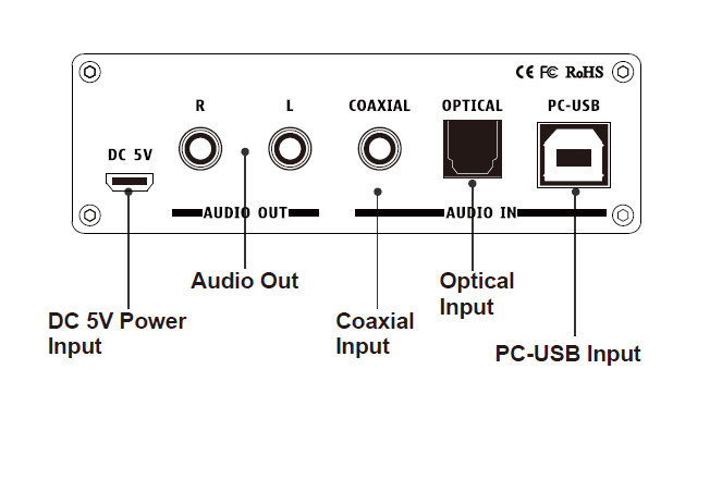

1: How do I power the DAC-Q4?
  • You will need to use the supplied Micro-USB cable to power it; we recommend using the PC-USB port/5V power adapter.
Note: The Micro-USB cable cannot be fully inserted into the device power port; please do not force it. Subsequent revisions have been made.
