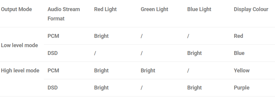

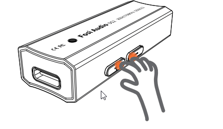

High and Low Level Mode Switching
Click the volume up and down buttons simultaneously once to switch between high and low level mode.
Indicator Light
